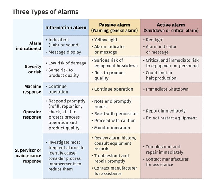

Not all alarms are created equal. Every alarm is a warning about something that is wrong, or is likely to go wrong, with equipment or production. Some alarms are literally your last chance to make repairs and prevent serious damage. How do you know when that’s the case? Let’s look at three typical types of alarms, what they mean, and how best to respond to them.
 •  Informational alarms indicate non-critical issues that need prompt resolution, such as a maintenance reminder or a “low material” indication. The fact that these alarms aren’t critical doesn’t mean that they can be ignored. For example, ignoring a low-material indicator on a blender, mixer, or hopper will ultimately affect part quality. Similarly, it is easy to turn off a PM reminder, but if you do so often, delayed maintenance will ultimately result in more serious alarms indicating possible or actual equipment damage.

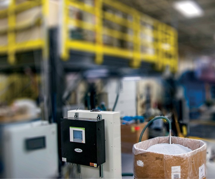

Auxiliary Equipment Alarms Informational alarms indicate non-critical issues that need prompt resolution. Here, an informational alarm on a blender control indicates the need to refill a hopper that has halted due to lack of material.
 •  Passive alarms (sometimes called “warnings”) indicate current problems that are likely to lead to future, serious equipment or production failures. Although passive alarms allow equipment to keep running, they should never be ignored. Think of them as you do a caution light in your car: Keep going, but proceed with caution, because something important needs attention. Operators should always record passive alarms and report them promptly to supervisors or maintenance personnel. Only after reporting and permission should operators be allowed to reset these alarms.
 •  Active alarms (sometimes called “shutdown” alarms) indicate critical equipment problems that will cause serious equipment damage or harm to personnel. For this reason, they trigger immediate equipment shutdown. In the event of an equipment shutdown alarm, operators must immediately alert supervisors, because prompt troubleshooting and repair by maintenance personnel is the only way to ensure safety and limit the risk of equipment damage.

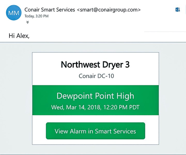

Auxiliary Equipment Alarms ​​​​​​​The latest auxiliary equipment is now available with configurable alarm notifications, which can send e-mails or text messages to maintenance personnel on mobile devices.​​​​​​​
It turned out that, after getting a number of passive alarms caused by the developing leak, the operator on the previous shift had adjusted the warning setpoint to a higher value, essentially blinding sensors to the growing performance problem. In addition, no alarm had been set for the Drying Monitor Probe, so temperature fluctuation due to reduced airflow was also not recognized.
