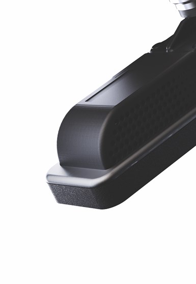

The foam on the base of Piab’s cobot palletizing tool (CPT) can be swapped out for suction cups. Source: Piab USA
In a release, Madeleine Sheikh, Piab global product manager, says that flexibility boosts productivity by enabling users to palletize four boxes simultaneously, instead of only tackling one box at a time. The CPT also features an off-center design that extends the reach of the cobot, while the compact, lightweight design places less strain on the robot arm.
The CPT carries an integrated piCOMPACT23 Smart Valve Unit for fast response times, and the product is also equipped with the COAX technology for minimized air consumption. Piab says the CPT is easy to reconfigure on-site because users only need to change the lower suction plate from foam to suction cups or vice versa, enabling it to act as multiple end-of-arm-tools.
The CPT comes with plug-and-play software and interfaces for Universal Robot’s E- and CB-series cobots up to size UR20. There’s also a generic electrical interface prepared for the IO-link which is compatible with other cobot brands.
